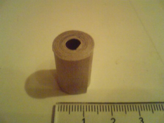

1st: Cut out a 15x2 cm piece of thin cardboard. Put some glue on one
side and roll it. (I use a roll out of many layers because it's more stable and will remain in form when pressing the staves on it)
Then you will get something that looks like this:

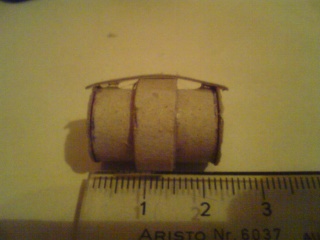

2nd: Next take a stripe of Cardboard about 5-7 mm broad and wrap it around your roll 2 or 3 times. (the more layers you take, the merrier roundly your barrel will be)

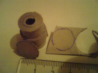

3rd: Now it's time for the heads of the barrel. Use the Roll as model and draw two circles on the cardboard. Cut them out and glue them on both sides of your Barrel.

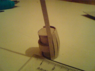

4th: Glue the Staves one by one on your Roll. (Cut one long cardboard-stripe, about 3 mm broad. Put the Glue on the roll, one point on each end and one in the middle. Then put the stripe on it. At last cut off the stripe. Thats how I think it's the easyes way to make the staves)
Half the Staves ready:

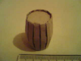

Ready for the last few steps:
5th: At last you cut a very slender stripe for the barrel hoops and stick it around the barrel. For the plugs cut off two tiny pieces of a toothpick and glue them on the barrel. ( don't forget that the plug on the head ist on the oposed side of the plug on the staves)
Ready to get painted...it has taken about 45 minutes.
